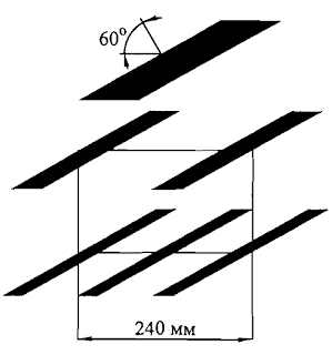

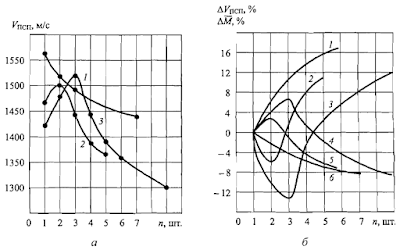

„The interactions between long rod penetrators and spaced armour have been studied extensively, which is quite natural considering that spaced armour is considered the simplest form of multilayered armour. However, from a conceptual standpoint, many spaced armour experiments do not represent the „Reflection-1” armour accurately as there is no thick back plate for the target setup. For example, one study featured in the book „Particular Questions of Terminal Ballistics” 2006 (Частные Вопросы Конечной Баллистики) published by the Bauman Moscow State Technical University on behalf of NII Stali, showed that it was possible to increase the mass efficiency by redistributing the mass of a single homogeneous steel plate into multiple layers in a spaced armour array, but it was found that there were serious limits to the effectiveness of this type of armour.”
„The two graphs shown below illustrate the difference in the velocity limit of nominal defeat and the change in mass efficiency obtained by splitting homogeneous steel plate. The graph on the left (а), shows the change in the velocity limit of nominal defeat for three tested angles. (1) – 0 degrees; (2) – 30 degrees; (3) – 60 degrees. The graph on the right (б) shows the same, but in terms of percentage, where (1) – 0 degrees; (2) – 30 degrees; (3) – 60 degrees. Additionally, graph (b) shows the change in mass efficiency, where (4) – 0 degrees; (5) – 30 degrees; (6) – 60 degrees.”
